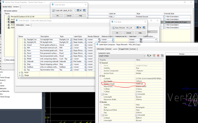

Hello Everyone,
I would like to express my challenges in civil 3D Section view.
As you show in the actual section view in During superelevation and their no superelevation it's showing what I want. however, I want to do some customize during superelevation how can i show this as no superelevation.
  Please help me to solve this issue

hosneyalaa
HI
as an idea
Make a copy of a drawing
and delete the super
Or do it as in the picture
Message 3 of 28
Ashraf_khan
it will not work actually if I disable superelevation corridor also change. I just keep Consider Superelevation and the label of the section as I share my photo of my post.

Message 5 of 28
Ashraf_khan
Actually, I just want text and arrows always on top of the corridor line for presentation purposes and print purposes. i know if export this file AutoCAD format it can possible by manually. I have around 200 km roadway 20.0m interval section. I wondering if I can do this in civil  3D it will help me to produce this work quickly.

hosneyalaa
hi
my language is not good
is this what you want
Message 12 of 28
Ashraf_khan
Yes i want the same like this

Ashraf_khan
which value shoude i use in this rotation angle?
Message 15 of 28
hosneyalaa
without entering any value
Just choose the first option
