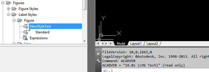

Verified, works in C3D2013:
Message 12 of 13
