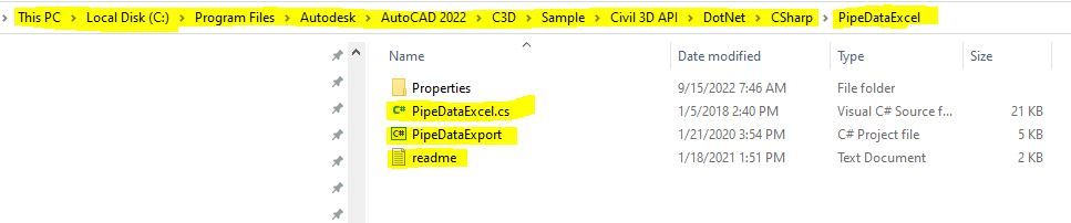

I am trying to update 3D civil sewer data using Excel, I tried the sample pipetoexcel code from .net api
but only with the sample code you can update the pipe data but not the structure data, I am trying to modify that code to edit it. the structures in excel but when importing the civil 3d it closes by mistake, I don't know what the error would be
Could you please help me since I have no programming experience, I sent you the code I am editing and it fails

TRY
Run Code in Dubbing To find The error

run the code in the path you indicated, I will send you the code files
As I mentioned at the beginning, the code works correctly but only to edit the pipe data, but since I also want to edit the structure data, I edited the code and placed fields to edit the structure data, but when executed in the civil 3d I can only export the data to excel and when I want to import civil 3d it closes and throws the error,
