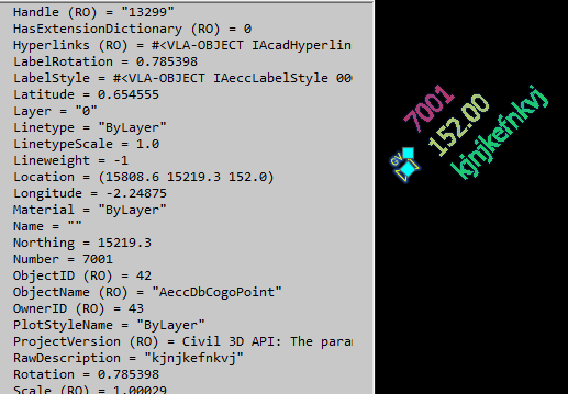

Anyone know the relationship between an angle in modelspace and a point's 'labelrotation property?  To me they don't seem to be even close (like 106° different).

Jeff_M
Can you provide an example drawing, John? In this image, both the Point and Label have been rotated 45 degrees. Both properties are showing this correctly (in radians).

Jeff_M
Hi John, (I can say the same regarding you! 🙂 )
It looks like a combination of things are going to affect the label rotation. Depending on the Point style setting for rotation angle and orientation reference, in combination with the PointLabel style's rotation property for the TextComponent(s), will all contribute to how the label must be rotated to be aligned.
In this case, the Point style is set to 0 degrees, oriented to the View. This is why the DViewTwist is affecting the outcome.
