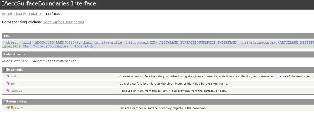

As an idea
You can add an surface boundary to it
And you inquire about volume
http://docs.autodesk.com/CIV3D/2012/ENU/API_Reference_Guide/com/AeccXLandLib__IAeccSurfaceBoundaries.htm
