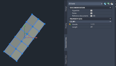

Hi, we don't have a problem getting values but our problem is that we don't know which automatic PropertySets are applied to an entity.
Settings:
One group with 2 definitions.
Applied to a Solid3D.
But code returns only one ObjectId for Length definition.
ObjectIdCollection psdColl = PropertyDataServices.GetPropertySets(entity);  // count 1 but entity has 2 definitions
Of course we can use propertySet.GetAt(propertySet.PropertyNameToId("Handle")); but how can we know that this automatic definition was applied to this entity?
Michal

To clarify your confusion here...there is ONE PropertySet assigned to the entity. That PropertySet has TWO PropertyDefinitions. By using the GetAt function you are getting that PropertyDefinition value assigned to the entity from which you obtained the PropertySet.
