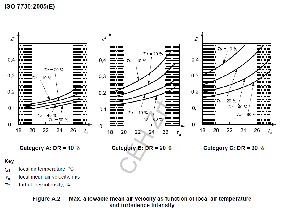

I'm looking to find a solution, for the more than 1 (100%) turbulence intensity inside the room.
How have to setting the turbululence parameters, that inside the room the turbulence intensity values be under 100% or some place, maybe a little more, because of the calculation fault?
The first picture, show the turbulence intesity. In the red zone, the intensity more than 1.
In the second picture we can see, the a 0.15 m/s velocity (iso surface).
Thanks for anybody help.

Thank you for your reply. In the Standard the turbulence intensity average value is determined. For tangential air conduction systems about 40-60%. How can I reach that for the room?

In the ISO 7730.
1.
2.
en iso 7730_TU_02.png3.

I've tried already, but it wasn't show major difference. By the way, that applies for the inlet, but the 40% in the standard it's concern for the all room.

Are you sure that the definition of turbulence intensity of the iso norm are the same as the turbulence intensity of a RANS turbulence model ? The parameter used in a thermal comfort studies might be different that the one adopted in fluid mecanics.
