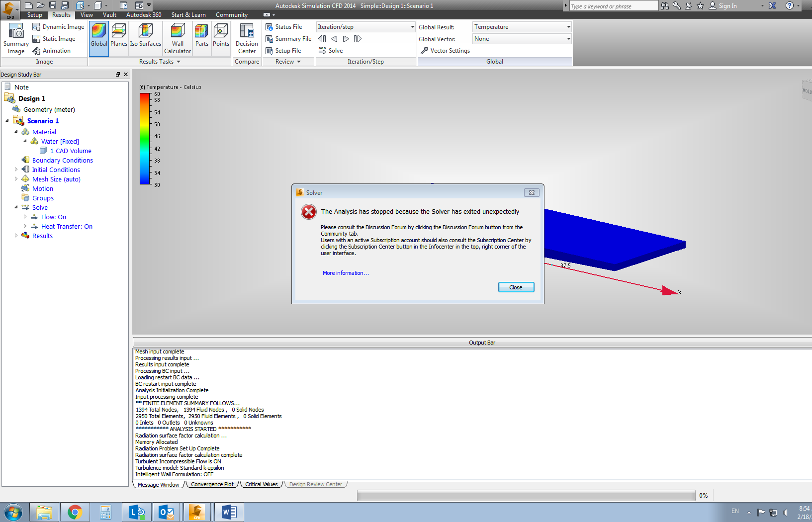

Attached please find the model.
For a single time solar simulation using steady state->no temperature change
For a 24 hr solar simulation using transcient with large/small timesteps (tried both)-->Error appear
Please help, Thanks.
Message 19 of 21
Jon.Wilde
I would expect this behaviour. You could run this with a heat flux on the top surface but for the solar model, you need an air dome/box modelled as you had before.
Your mesh needs a lot of refinement too - at the moment there is only one element from the top to the bottom of the volume. Start with something like a uniform mesh refined down to 0.7 for example (I tested this, it's a little coarse still).
Turn off radiation (no air and only one part so no need for it), I also turned off flow and turbulence as a quick example, it runs fine:
Animation of it heating up here (obviously this isn't going to be realistic but it gives you an idea).
Hope that is useful
Jon
