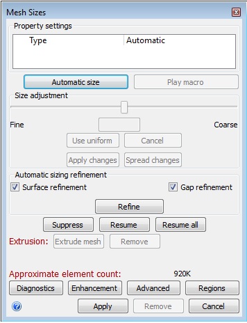

Message 6 of 10
@Anonymous wrote:
Another thought, do you have enough memory for about 18M elements? Perhaps you're using the page file, which slows things down considerably. Check CFDMesher.exe in the task manager
Hi erichul, thanks for your reply.
How do you check that there are 18M elements? Because what I can see from the approximation is only 920k (yeah, I know it should be more).
The computer that I used to run the simulation has 32GB RAM. Therefore, if according to Autodesk 2GB RAM for 1Million elements, then yeah this would not be enough because I would need to have 36GB RAM for this simulation.
I attached is the task manager screenshot. So, is the paged pool or page faults signifies that I am using the page file?

Hello
The element count is approximate and sometimes it can significantly overpredict or underpredict. I prefer to keep my task manager open to check the memory usage. To avoid even starting a job with a oversized mesh I've set a default flag, mesh_size_limit = 250. This basically abort jobs containing a mesh with more than 25M elements. Additionally, you'll see the mesh count in the output dialog and in the report generated by Autodesk CFD. For very large cases, one case follow the mesh generation a bit more closely by looking at the mesh.log file. Even better would be if there is was flag to terminate the mesher when it exceeds a specified memory usage, however, this isn't available.
Message 9 of 10
