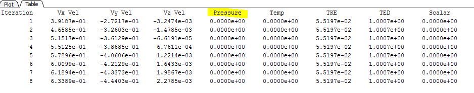

Right now your convergence pattern acting very sillyCapture.JPGI also check your mass balance on every intlet/outlet, here what i found

For the damper you can run transciently and applying a transient pressure BC who's time dependant. I choose piecewise linear but you have other mathematical function.
Capture.JPGIf it's more suitable for you, you can inverse your volumetric flow rate BC : Keep  your VFR BC at the outlet to simulate your damper correctly and change the other VFR BC for a pressure BC at the entry of your system.
Keep in mind that if you have multiple volumetric flow rate boundary condition there need to be unidirectional
(they're all coming into your model or they're all driving the flow outside of your model)
I just ran your simulation with the new setup and i still have a non-existent  pressure,  that is not normal !
Capture.JPGIs your gemetry are correctly designed ?
it is the first time that i saw this behavior not sure what could be the cause.
