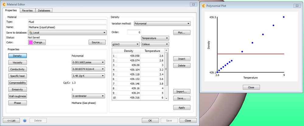

Material editor.JPGMaterial enviorement.JPGThis is how my materials editor and materials enviorement tabs look like. Should i change something here?

Regarding this last point, i think you made an error relatively to the density of liquid methane :
This is the way you setted the physical propreties of the liquid methane
In other hand this is how it is defined on the autodesk database :
autodesk database (liquid CH4)autodesk database (liquid CH4)
I check the density dependancy according to the pressure applied at 100degK and there's no significant change :
  • 3 bar = 439.09 kg/m3
  • 2 bar = 439.01 kg/m3
  • 1 bar = 438.94 kg/m3
My interpretation of this is you can use a constant value for the moment and use the methane material in the autodesk database. Right now you have a huge error on the density value.
For the compressibility option, i think you should check the magnitude of your velocity field with the new density values and compute the Mach number to know if compressibility is relevant to your analysis.
