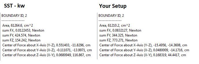

Hello. I try to calculate drag coefficient of a regular 3D wing. But in result I got value - 0.56. I think this is a very huge value for wing.
Wikipedia says that whole Cessna 182 have Cd = 0.027: https://en.wikipedia.org/wiki/Drag_coefficient#Aircraft
For calculating I use tutorial and formula published here https://knowledge.autodesk.com/support/cfd/learn-explore/caas/simplecontent/content/calculating-the-...
My parameters for formula:
Force by direction 380 Newton;
Velocity 50 m/s
Cross sectional area 0.45 m2
Air density 1.2
Please, review my model located here https://drive.google.com/file/d/1uwAfzZR1i6F6BaviWUa09O--xCsmIG-U/view?usp=sharing and tell me what I am doing wrong.

Your mesh is clearly too coarse! And you will more than 3 boundary layer for this kind of analysis.
Try to refined your model first and foremost

Hello @Anonymous ,
Few thing to enhance your result.
1. You should simulate your model in 2D instead. The computational cost of a 3D model is too high. By doing this you will be able to allocate a lot more element in your 2D model which is responsible for an accurate simulation
2. Choose a SST-kw turbulence model instead of the k-epsilon
3. Switch to incompressible. Compressible analysis is more suitable for high speed velocity and necessite unknown boundary condition instead of a 0 pressure gage.  Your BC are perfectly set for an incompressible analysis, good job !
4. Supress the mesh from your wing. your simulation will solve faster !
5. Add extra boundary layer near of your wing (5 -10) and make sure that your Y+ values had a correct value.  With a SST model Y+ should be around 1, with the k-epsilon Y+ should lie between 35 and 350.
Up : Your simulation
Below  : SST-kw - 5 boundary layer
velocity profilevelocity profile
You see a tremendous difference in the result with just a simple refined meshing.
Good Luck
