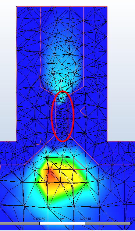

I ran it as is and it didn't generate any errors as you state in the original post.
However, the flow through the nozzle is blocked as seen in image below.
Having said that, the model needs work:
1- Finer mesh overall.  Mesh is too coarse.
2- Activate Wall Layers.  They are turned off by default when you have motion but since your moving parts are outside the fluid domain to start with it's OK to turn wall layers on.
3- Create a refinement region around the nozzle(s) to better capture the flow.
4- Suppress the SS part, no need for it.
5- Set Inner Iterations to 1.  I don't think you need 4.
