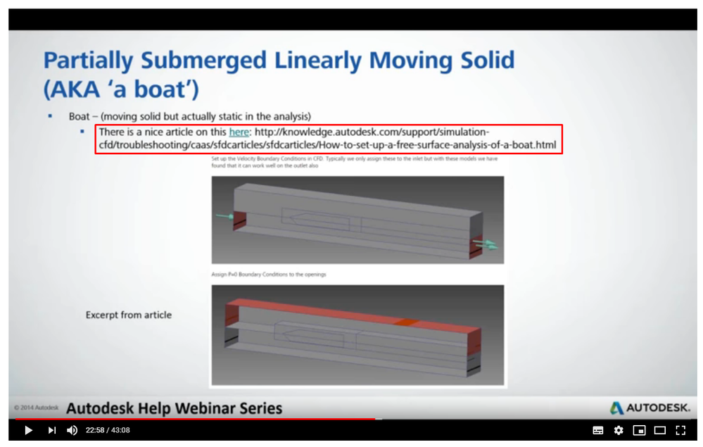

I believe the approach mentioned in this video would be sufficient (23:30): https://www.youtube.com/watch?v=CQH5z0qmPYo&t=1372s
A few second earlier this video mentions an article about this setup, which I wasn't able to find:

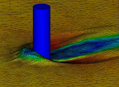

Hi @Anonymous ,
I can tell you will need to have a finer grid, the water free surface looks rough, I can even see the tetrahedral shape of the water.. Try the following:
- Firstly, you could train on a small CFD model to get an idea of the mesh requirements here if you need to capture a boat wake (eg it can be a small cube floating instead of a big boat)
- You should avoid to include solids in the numerical grid, then you save some mesh count hence cpu time
- More importantly, work on a half-symmetric CFD model, mirroring will do the rest
- My last suggestion would be to refine the grid step by step until you are able to capture a wake.
- Look up in the forum for similar post https://forums.autodesk.com/t5/cfd-forum/free-surface-boat/td-p/6537902
See below the mesh density required to capture some free surface flows
Coarse grids and poor solver setups will lead to numerical divergence or unreal behavior for sure, convergence plot will likely give you an idea of the solution health.
unhealthyunhealthy
betterbetter
Take a look at the files here, 'FS1' is to show you numerical instability due to a poor setup and 'FS2' is to show you the difference between coarse/fine grid (LINK)
