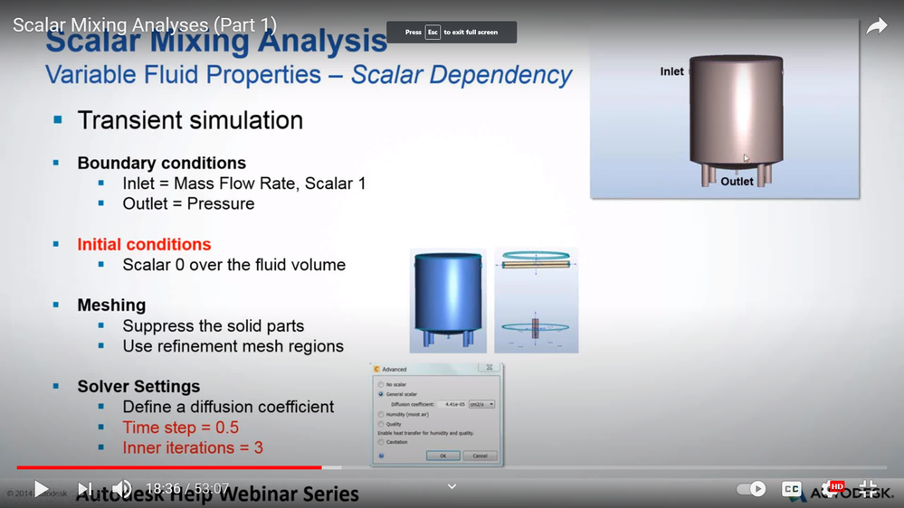

Some of the confusion of this comes from the fact that for SimCFD if you have 2 fluids mixing such taht you have A coming in one sectino and B coming in another, the way we set this up is via Scalar mixing.
What this means is that the entire domain will have a single material (we'll call it "Mixture" as an example).
Then if you modify this "Mixture" fluid you would set the Density/Visc/etc to be table driven and to Vary with respect to scalar
Set up the table as such
    Scalar    Density
    0           ## kg/m3 of Fluid A
    1           ## kg/m3 of Fluid B
Then on all inlets you will specify whether Scalar 1 (Fluid B) or Scalar 0 (Fluid A) is coming in to the domain at that opening.
Be sure to turn on Scalar mixing under the Advanced section, but otherwise this should get you moving forward.

The information on Scalar Mixing and settings was valuable and I understand most of that.
It might help me, if you could explain how the mixing tank with three inlets was constructed in CAD to allow two different fluid materials to be assigned and mix without touching?
Mixing Tank as Outline
In this screen shot please note that the visibility of tank body is set to Outline, both Water and Methane inlets appear to be constructed as one pipe that protrudes either side of the upper tank. This is where I am confused. I am thinking of two inlets welded to the tank which is empty. How can two dissimilar fluids be defined at both inlets of the same pipe without creating problems? How can either fluid enter the area within the tank and mix if they are contained inside a pipe? Then there is the drain pipe, it would have a fluid mixture of Water and Methane. Would you only need to define the outlet pressure at the discharge of the pipe and not the material?

marwan_azzam
CFD does not allow two different material to be touching each other.
The way scalar mixing works is that you only have one fluid with variable properties and one of its properties is defined as a function of scalar.  By definition, the two fluid cannot be very dissimilar such as oil and water where both density and viscosity ere very different.
Typically a scalar of 1 represents one fluid and a scalar of zero the other.
I hope this helps.
Marwan
marwan_azzam
The model that is generating an error of Two Different Fluid Materials Touching is because you actually do have two different fluid materials touching!
If you mesh the model with only Air as the fluid you will see what I mean.
Marwan
