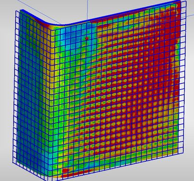

In 2015 I am getting just over 20,000 cfm through the larger filter and for some reason I cannot measure the smaller planar one (I get a zero). I was going to measure these two and then subtract the difference from the 2400 to give the result for the curved resistance.
Todd's suggestion is good, if we use surfaces, we will still have the air blocks in place to measure the flow within, which ought to work better.
We can at least see the flow distribution really nicely:
