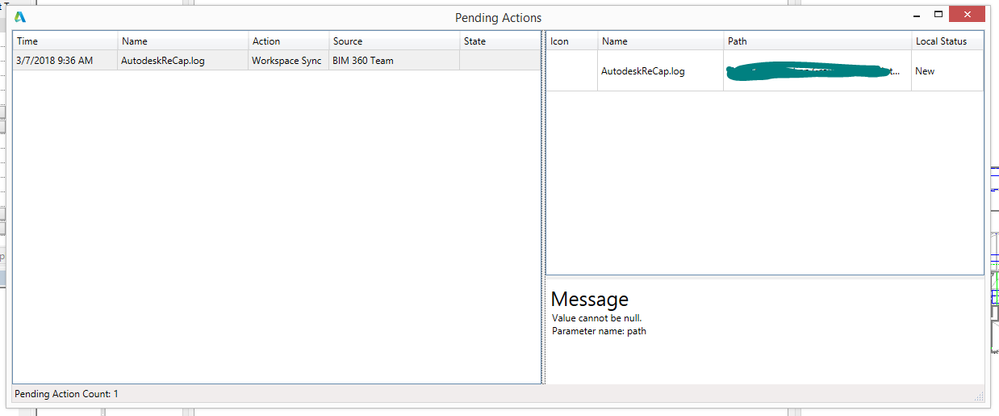

I'm not sure if this is a related issue.  In earlier tests, we were able to link point clouds directly into hosted Revit files directly from Team, eliminating the need to download and re-path at every machine.  Today we're experiencing a path = null issue in synchronizing data.
The point clouds were formerly linked from our local server.  We've started to migrate them to Team.  Now when using Reload from, Windows Event viewer indicates an issue with Desktop Connector, and Desktop Connector indicates an issue with the path value:
"Value cannot be null
parameter name: path"
In the same dialog, the path describes the hub, project and location of the file.
Any ideas / known issues or limitations?  Should we remove the link and then re-insert the link directly from Team?
