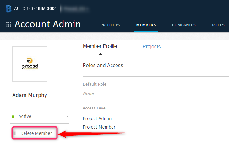

s.odwyer
You can remove them. You need to go into each user individually and then click remove.
I had a case recently where Autodesk had to re-enable on their end the users email address.
