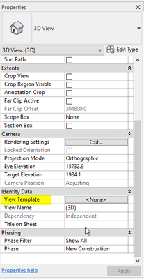

jamie.sidford
I got a response from Autodesk
In Document Management and in Model Coordination, you are opening or viewing distinct "3D-Views" with pre-defined visibility settings.
This is different in Design Collaboration: Here, you are not opening a distinct 3D view, but you are usually viewing the "project model" of a specific team. The project model is usually derived from the "default 3D-View" ({3D}):
Note: If your model does not contain the default {3D} view, this view will automatically be created with your default "view template" settings:
So based on the above I checked my model and the default view had been deleted.  This means Design Collaboration was creating a default view using whatever template I had set to be used when creting new 3D views in the model. That template had the railing category turned off!! tada!!
I created a new view template and made it the deault one to use when creating new 3D views in the mode. After re-publishing the model the project model view in Design Collaboration was fixed.
