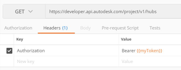

No luck. Can you show me what your postman request would look like for the two legged auth token. I just need to see how you format your body.
Message 7 of 11
mikako_harada
Here is how my postman looks like:
I hope this leads you to find a problematic spot.  If this still does not help, we will need to do desktop sharing or something.
Mikako Harada
Developer Technical Services
Message 8 of 11

Ok so I'm making progress with the three legged token but it's the wrong hub... And the error is still there. Desktop sharing would be fantastic too.

For anyone who runs into this issue here's what fixed it on my end:
This response is of status 200 indicating that you have completed the OAuth correctly. What's missing is the performing of setting up your app as approved with a BIM360 Admin for the hub you are trying to access
Here's a very helpful and incredibly well documented guide for doing this.
