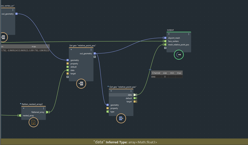

Hey All-
Having problems creating a mesh user property while following the masterclass tutorial video. I have attached an image displaying my network.  You can see I add a property to the mesh called "relative_point_pos" and a watchpoint shows that there is data entering the set_geo_property but when I try to get the property immediately after another watchpoint shows there is no data.  I have tried setting a variety of data types but no luck.  Any thoughts?
Rick

Following up on this. The type wants to be array<Math::double3> when getting and setting values in get_geo_property and set_geo_property for my data.  There is no way to set that type through the node UI.  The only way I was able to solve this was to pipe the data into the "type" port and let the node figure it out.

Sorry,not quite correct (and this is driving me crazy).  See attached images. I was able to set the data type as array<Math::float3> earlier in my tree which is selectable as a type in get/set nodes.  Notice that in both instances Bifrost sees the data as float3 but only the version with the connected array to "type" passes any values.  bifrost_connected.pngbifrost_unconnected.png

Can you share your scene? Then I can have a look. You need to be sure that both types are set to array<Math::float3>. You can see the type by middle-clicking on the port.
Message 5 of 11
The type is set to array<math::Float3>but for some reason wants a connection to determine the type.  I have shared my workfile.  In the Bifrost graph editor under the tab for "drive_meshes_with_face_points" there is a node called "get geo relative point pos" that has an input into its type plug and a watchpoint after the node.  Notice that when disconnecting the plug there is no longer any data in the watchpoint even though the type is still correct.  Thanks.

I recreated new set and get geo_prop nodes and it seems to be working now.
When I turned on the display of the node type (pressing t on the keyboard) it revealed the set and get nodes as type compound. They should have revealed that they were of type set_geo_property and get_geo_property compound nodes.

This graph looks correct to me. I think maybe the issue is that without a connection to the output, watchpoints don't actually work. Your data connection there is going to the out port of a compound called "make disjoint mesh", which is not necessarily being pulled.
Here's a workaround - assuming the object connection there is being pulled. The set property is a temp node just to ensure the data is pulled. Another workaround is to use dump_object to put it into a text file.

This worked for me. Looking further downstream the data was getting propagated. That watchpoint was not being updated. Thanks
