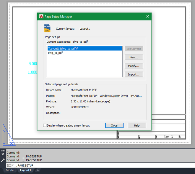

paullimapa
My observations on the drawings current page setup:
1) The current Layout1 default Page Setup is: <none>
2) The current setup is NOT centered on the sheet...the dashed lines are the page size print margins:
3) After I apply the Page Setup: dwg_to_pdf to Layout1, then the sheet is centered on the plot
4) But since the current Print Area is Extents & Scale is Fit, then:
Test 1.dwg now saved as Test 1 Page Setup dwg_to_pdf Microsoft Print To Pdf.dwg
Test 3.dwg now saved as Test 3 Page Setup dwg_to_pdf Microsoft Print To Pdf.dwg
This ends up with different output as shown in attached PDFs & Page Setup Window screenshots:
Test 1 Page Setup dwg_to_pdf Microsoft Print To Pdf Test 3 Page Setup dwg_to_pdf Microsoft Print To Pdf
5) A better option since these drawings are actually designed for 1=1 scale Letter Size print outs I created a new Page Setup called Dwg To Pdf using this named built-in pdf printer and instead of Extents I used the Window option designating the exact lower left & upper right corners of the plot area and with scale as 1=1:
Test 1.dwg now saved as Test 1 Page Setup Dwg To Pdf.dwg
Test 3.dwg now saved as Test 3 Page Setup Dwg To Pdf.dwg
So you end up with matching and accurate scaled plots and now the batch output pdfs from Dwg Trueview look exactly the same see attached:
Test 1 Page Setup Dwg To Pdf.pdfTest 3 Page Setup Dwg To Pdf.pdf

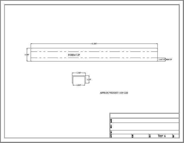

pvr1498
@paullimapa
thanks for responding.
I tried way you suggested mostly it works but some drawing i have that I've attached here. Where drawings are made in model and Border are added in Layout.
How would i keep that in center and batch select page layout when I'm batch plotting to convert into pdf.
Message 8 of 10
paullimapa
First of all the dwg has errors that require recovering & saving:
Then you have to go through the same Page Setup process again using Window as the Plot Area and Center the Plot like the way I mentioned previously:
1. Enter command PageSetup on Layout1:
2. Select DWG_2_PDF
3. Click Modify button
Under Plot Area click Window
Lower Left is osnap end point of bottom left corner
Upper Right is osnap end point of upper right corner
Click Preview button & now you see sheet centered on the page
Back on the Page Setup Manager window still with DWG_2_PDF selected click Set Current button
Click Close
Now Graphic screen also shows sheet centered on page
Enter QSAVE and close dwg
Now you should be able to Publish this along with the other dwgs with the border centered on the pdf output.
