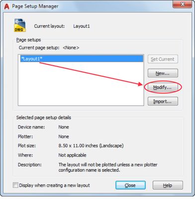

ChicagoLooper
Hello @Mb_Jonas
Instead of changing the pen assignment try scaling the line weights and see if that helps.
Right- click your Layout Tab=>Page setup manager.
Check boxes named Plot objects lineweights and Scale lineweights.
