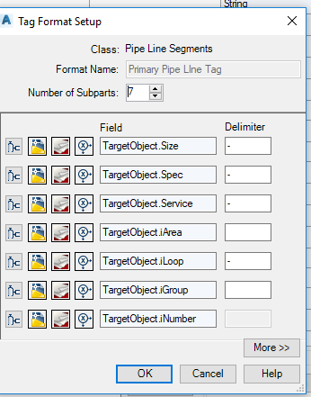

Trying to get my off page connectors working. But they are not passing the All the data that is on the original line.
I have changed how lines work quite a bit actually.
First I am using the target objects properties to make the tag. This allows me to create an assembly and put it in my toll pallet as a block without losing the data that would have been stored in the PipelineGroup. This data does not exist with the block.
Secondly I have forsaken the LineNumber Property. Instead opting for a segmented approach. the area which is pulling from the Drawing Properties. iLoop which is part of the PipelineGroup Properties.  This allows me to copy a drawing change one drawing property and change every device on the page.  I am also acquisition these properties to every device via the lines connected so it is a true cascade of data.

Use PLANTDEFINECALCPROPERTIES to create a new property using the concatenation symbol || and have it pulling from whatever other source properties you need.
