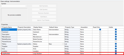

Our current Instrument Tag includes the Loop Number.
The Loop Number is currently defined as a Number type.
Now, our client wants to include letters in the Loop Number, so I need to change the property type to String. However, before making this change, I created an instrument and assigned its tag. I was able to input “TEST” as the Loop Number, and no error occurred, even though the Loop Number is defined as a Number type.
I was wondering why I was able to input letters in the Loop Number despite it being defined as a Number type. Should I change the Loop Number to a String type or not? If I do not change it to a String type, will there be any potential issues in the future?

This is explained by the fact that in the "ProcessPower.dcf" database the "LoopNumber" property is declared as a character string.
I noticed that certain properties did not have the same type of data between those declared in the project configuration and the ".DCF" database.
I think that for some properties the type is hard defined, without being identical to the database.
We find the same case in 3D for the numbering of welds. In the project the "WeldNumber" property is declared as a character string, in the "Piping.dcf" database as an integer.
As a result, we cannot, unless we manually modify the "DCF" file, define a weld number as a character string.
