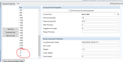

When duplicating a component in a catalog it puts it to the bottom of the list.  Is there a way to organise so all same size fittings are together?  I’ve tried exporting and importing with excel with no success.  Have any apps been developed to help with this?

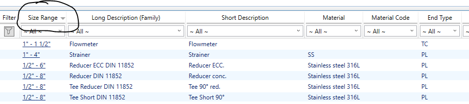

@kevin.edwards6L7CR just click on size range it will arrange the component as per size.Capture.PNG

kevin.edwards6L7CR
Thanks for the feedback, it's more when I add here though. Is there a way to organise the sizes?  Once I start populating with all the diffrent wall thicknesses it will become difficult to manage.
rajendra.prajapat
@kevin.edwards6L7CR no default functionality available for this task.
