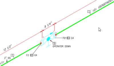

Good afternoon,
For a specific client we are required to use multi-portedhygienic valves. Unfortunately the isometric symbols for such valves are not standard in AutoCAD Plant 3D. That's why I proceeded to create a custom symbol for a 3-port valve, I used the standard 3wayvalve block symbol from the Isosymbolstyles.DWG as a template and created my own symbol (see screenshot: ISO symbol style model).
Now the problem that I'm having is that the symbol will not rotate to the correct orientation. I added a screenshot of the 3D model space of an example set up with the 3-port valve and the result when I create an Isometric of said set up. Also the valve acts like a sort of break point but there is no reference to the next sheet generated.
Am I missing something or does anyone else experience the same problem?

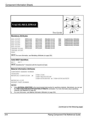

try making your symbol like the valve-multiway from the PCF reference guide (do not alternate heights, but keep them at the same lvl for Port1 and Port3):
Also make sure your Port1 is positioned on the left side of your iso-symbol

Michiel.Valcke
You don't need the flip parameter, so delete it,
make sure your Port1 is at the left side and make sure your left and right ports are ligned out at the same height.
make sure the position of the 3D ports correspond with the position of your ports in the iso symbol.
You don't have to draw port4 and port5 from the PCF guide (I'm not sure but this, it could be necessary to add the parameters even if you haven't drawn any of the 'triangles' - for the same reason you probably should add the second CP)
Use the type Valve-Multiway and start your skey with MD or MZ (the last part is not necessary unless you want to generate PCF's to send to other piping software)

Good morning Michiel,
I followed al the steps you mentioned as well as the use of the multiport valve SKEY (which I did not use before ''o.o) but then it generates 3 models of the same block. See screenshot below.
Maybe I should rephrase my question. Is it possible to generate this kind of setup from a multiport valve (I drew this by hand because at the time I did not have time to investigate how to automate it).

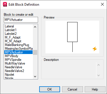

nevermind, I got it. I feel a bit silly now. @Tom_Jipping don't make the custom iso symbol, use the separated symbols. There is a block for the port, there is a block for the spindle and a block for the actuator, just use the MDBW or MZBW, skey's.

@Michiel.Valcke ,
SKEY:
TYPE=VALVE-MULTIWAY,SKEY=MDBW
ISO Symbol:
MPVBody
MPVSpindle
MPVActuator
IsoSkeyAcadBlockMap.xml
  <SkeyMapMPV SKEY="MD??" AcadBlockBody="MPVBody" AcadBlockSpindle="MPVSpindle" AcadBlockActuator ="MPVActuator"/>

Tom_Jipping
@h_egerUsing the standard multiport valve body from the PLANTCUSTOMPARTS command worked in combination with the right SKEY and VALVE combination!
I think the problem I was having was caused by the 3D part of the valve, this was a STEP file that I converted to a Plant3D part. Maybe because of this the 3D model is missing some parameters for it to show properly on an Isometric.
I guess from now I just have to copy the dimensions from the STEP file to the standard Plant3D model.
