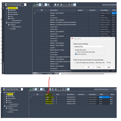

I want a to run and export a report to excel on the ‘Engineering Items’ on a P&ID. Is there a way to add a column that will add the tag description to the items that have a tag description? The nodes below the ‘Engineering Items’, 'Equipment', 'In Line Assets' etc. show the tag description, but the Engineering items don’t.

Dear @paul_braithwaiteCKX8G ,
No, only in a roundabout way.
Why don't you work with the Report Creator where this is possible?
trying report creator now 👍
