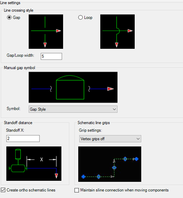

AndyL_Work
Thank you for the tutorial it has been very useful.
I have a question about the possibility of being able to change the arrow style with a substitute option.
This comes about from a client asking if it is possible to have connection dots where the lines meet at a "T", similar to the method used in Electrical schematics. As I can't see a way to add this in the Schematic lines setting (We only seem to have the option for changing the gap or loop) I was wondering if it might be possible to use the substitute option similar to when placing/changing valves?
Any ideas would be very welcome.
Kind regards
Andy

Message 10 of 13
AndyL_Work
The client is looking for something like this,
but as you will appreciate changing the block for the flow arrow would only work at the downstream end.
the "specification" is that the "T" connections are to have a Dot and the crossings are not to have a gap or loop.
This is odd to me but that is what they are trying to achieve, we can always create a 3-way valve-type block but that would have to be placed.
Any ideas?

Message 12 of 13
AndyL_Work
With my knowledge of plant and the data structure I can't see how it is possible, AutoCAD Electrical uses this function/format OOTB but I can only see a reference to how lines will cross (gap or loop) in the Project Setup
As previously mentioned I can imagine that it might be possible to creat a version of a 3 way valve but that is not ideal as it would require the designer to place an icon at all the intersections. I have expressed the opinion that I have never seen this requirement in PID before but it seemed to be a client "standard" that my client is expected to use.
