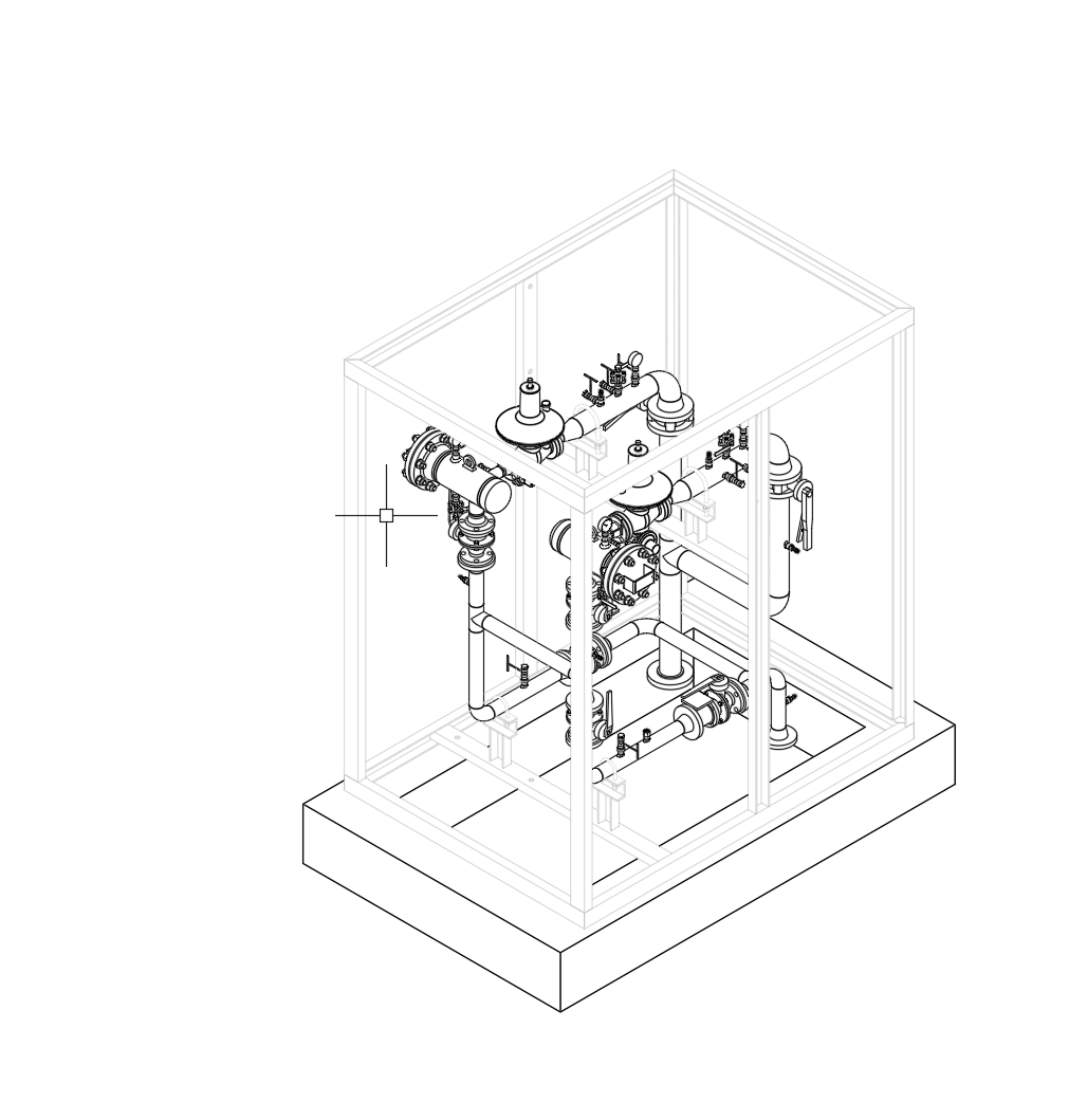

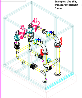

In orthographic view, is there a way to show the pipe support and frame transparent so that the pipe assembly is more clearly visible?

there's a quick answer: No, that's not possible in the orthophoto creation of Plant 3D.
