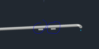

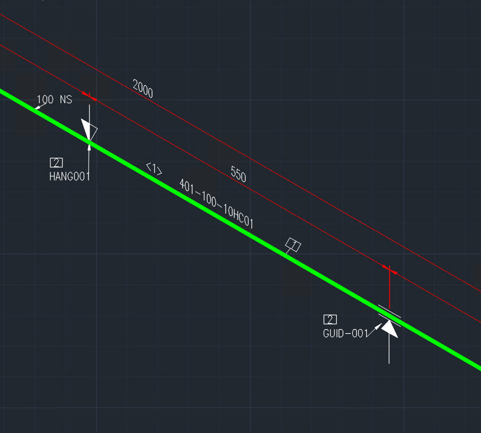

I have a problem with the orientation of isometric symbols as per title and below picture:
How to clear this issue?

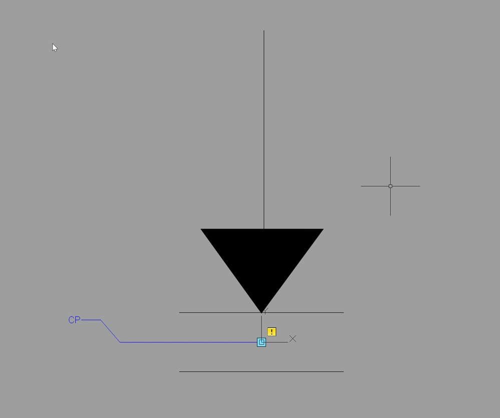

I'm so sorry for providing little information about the above case, this is the support I tried to customize:
Finally, I found the solution, Maybe it's not perfect but at least it's working. I copied the existing symbol and mirror it

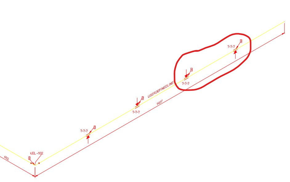

Dear @Kevin_Anh ,
Yes, there is a small error in the alignment of the ISO symbol "GUID" I have simply rotated the block "Support-GUID" by 180 degrees and then the alignment is correct. I have this point on the agenda for development.

To just rotate this support does not work. If I rotate the block it flips any support that uses that skey.
This image is purely done as a test/example but we're having this issue on a project. We have u bolt on some line and then this pipe shoe. Only way I can see to make this work is to have different skey available and change the shoe support to use a rotated skey.
