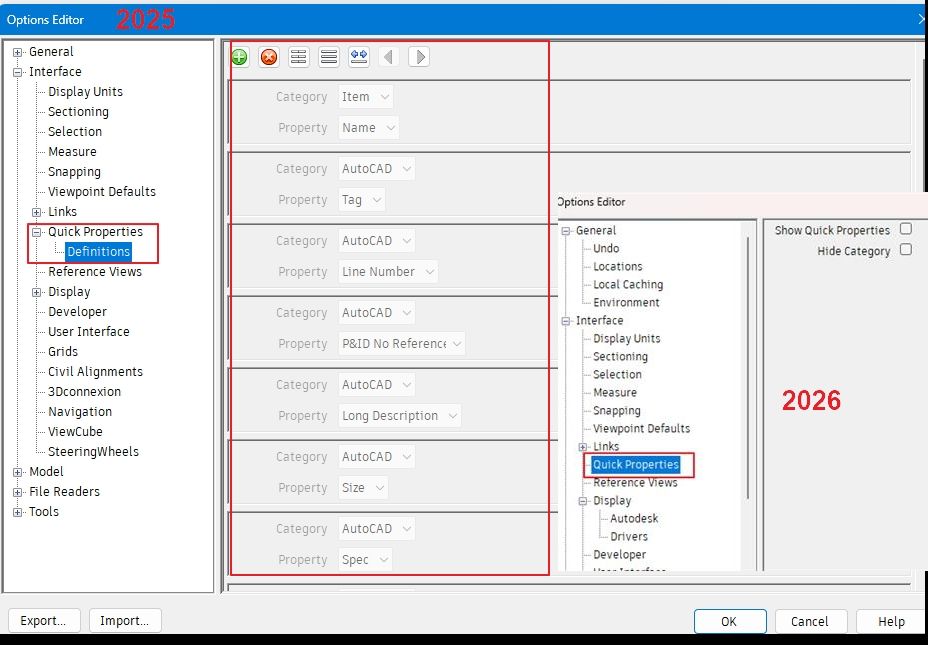

I tried installing the latest Navisworks Freedom 2026 on 2 different machines and noticed that Quick Properties Definitions are missing. Is this a bug or is it move somewhere else.
See below screen shot.

@Ray_K ,
this functionality no longer seems to be available in Navisworks 2026.
Please contact Autodesk support.

I found it. They move to Property Sets. You can create few different Sets as required.

In 2025, export your quick properties definitions out to a xml file.  Then take a look at the data using notepad++.   With the definitions open in notepad++, open the quick properties using the new Property Sets button near the Quick Properties button in the home ribbon, display tab.   Edit the quick properties, locate the similar property that is shown in the list in notepad++ and check the box.   Once completed, all your old quick properties will now show up in 2026.
While QPs have always been difficult to manage pre 2026, this new method is way faster and easier to update and fix...
