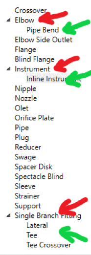

Hi All, do we have any documentation that list all available 'Group' in python scripting.
@activate(Group="XXX", Ports=1, TooltipShort="z", TooltipLong="z", LengthUnit="in")
I mean this "XXX" part.
Thanks.

@bagusvirdo ,
All with the exception of the ValveActuator

Thanks for the reply @h_eger ,
So, for the indented part (marked green) we can ignore it, and using the parent name instead, right?
but for example for valve,, what I know, the script is like :
@activate(Group="Valve, ValveBody", Ports=1, TooltipShort="z", TooltipLong="z", LengthUnit="in")
is it came from this ?
