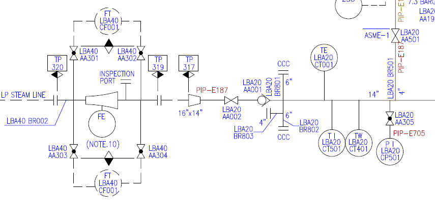

Hi again guys,
Lets go with another question.
If I have this line, how I know the flow direction?
I understand that the FE is a flow nozzle wich could mean that the flow goes to the left?
The symbol with the right arrow I dont know what it is, but make me thing that it is right flow.
Wich is the good one?
Thank you 🙂
h_eger
Dear @Anonymous,
your excerpt is the MP to LP Steam preperation. The flow direction is here only by the check valve
LBA20 AA001
to recognize
please get information about your new work in nuclear power plants is not played but worked with high levels of engineering!

third picture. For Flow direction you have to check the complete PID or experience with Steam lines. But as @h_eger said, in this simple pic, only the check valve is an indicator for the flow direction. and the flow meter FE which are only usable from one side.
