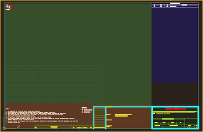

Iso draw areas, Iso no-draw areas, and Iso table areas -- the things that these buttons make
that look like this
-- all have their configurations saved in the iso style and not in the iso DWT template, meaning if you copy the "iso.dwt" drawing template file (it can be named another name) from style A to style B, the iso areas that were set up in style A's template will be replaced by the last configured areas on style B.

When I open style B's title block in project setup, it has style A's template; however, it uses style B's areas as they were last configured for that style.
Note how the no draw areas changed, especially at the bottom.
Does anyone know where these drawing areas are stored?  I don't remember them being in IsoConfig.xml, but it's been a while.

Note that the drawing template file (.dwt) stores drawing areas -- you can see this if you open up the template using vanilla AutoCAD or by using the "Open" button on the quick access toolbar in Plant 3D -- but these areas are overwritten with the iso style's when loading the template through project setup.  (I call the ones retained by the dwt file "ghost" areas.)
I haven't tried running an iso with these templates.  I am operating under the assumption that it's the areas shown on the template in project setup that dictate how the iso is generated, not the "ghost" ones saved in the standalone dwt file.
Sometimes when copying the template over, I'd end up with two blue areas.  One was the "ghost" BoM area and the other was the BoM area from project setup/the iso style.  Only one of them had a table, the other was just a blue hatch.  Not sure if this would cause problems.
Overall, the iso drawing areas feel a little unstable.
