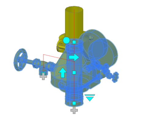

Hi Guys,
What iso symbol should I use for a Component with multiple connection to show it properly in isometrics

You can try: TYPE=VALVE-MULTIWAY,SKEY=MDSC

Thanks a lot sir
zirudezirude
The only thing that is missing is the component dimension
