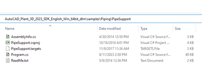

I need to add that measurements.
See the image for reference.
I want to replicate the behavior of creating custom support through the spec editor in API/SDK.
Using the API/SDK sample doesn't include measurements before placing it to the pipe.

My dynamic input is enabled.
I was talking about when placing the custom object through this example from the API SDK, the measurement is missing.

I didn't define a connection point for support,
I'm just using the example.
How do I implement it in the current example of SDK API?
dave.wolfe
It sounds like you are wanting the user interaction that happens when placing the support. Is that correct? If so, that is an AutoCAD jig (probably an entity jig), and you would have to implement that via the AutoCAD api.
