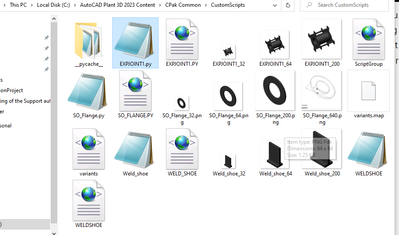

Thank you for reply.....Actually i"m getting the components but the preview images are not available;
below shows how i saved inside custom scripts;
in Spec Editor;
why this happening??

matt.worland
That looks semi-correct with a bit of guessing.
I'm not sure what the extensions are for your expansion joint images. Some of your files have extensions showing while others don't, and I'm guessing that if you turn on extensions for your files, you will see that some have duplicate extensions.
Turn on your extensions here:
Then make sure that your PY and PNG file names are exactly the same, with the exception of the _size at the end of the images.
You should have the following:
EXPJOINT1.py
EXPJOINT1.xml
As far as I'm aware, it only takes a matching _200.png file to be found, so the image shows in the Spec and Catalog.
If my reply was helpful, please give a "Thumbs Up" or "Accept as Solution"

tinuthomasGE9RJ
it's working thankyou sir.........
Message 12 of 15
matt.worland
Glad to hear it. Also, be cautious of case-sensitive names; make sure everything is EXACTLY the same.
