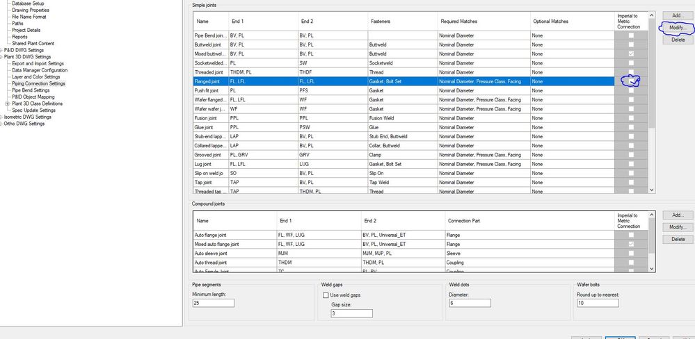

Generic Equipment Nozzle Library will only give ANSI Nozzle's in Imperial and DIN Nozzle's in Metric
our Project is Europe based and ANSI /Metric. If I create a Project in 'Mixed metric' it still requires me to toggle the Flange joint / Imperial to metric connection - Toggle 'ON' (tick as shown below) to connect to Equipment Imperial ANSI Nozzle with Metric components (but then your Metric on Metric components do not connect so then Toggle 'OFF' (un tick) to continue) This Toggle 'ON' & 'OFF' , do you know of a better way can I edit the Generic Equipment Nozzle Library?

Q: Where is the Equipment Nozzle Library stored so I can edit to resolve this? - Projects in Europe are in millimetre's but not all DIN Spec & Australia uses ANSI Metric the ones that I have worked on anyway.
Most companies are fine with AutoCAD 3D models customised or even dead graphics with an edited nozzle sitting in place - our current customer requires an easy to edit generic for future replication and minor changes

It lost the connection on the 'AUDIT' though pout
thank yo Chris downing from 'Man and Machine'  well chuffed all you do is add/duplicate the flange connection in the simple connections and call it 'mixed flange connections' and tick the Imperial/Metric ...... it works !!! made my dayequipment.JPG
