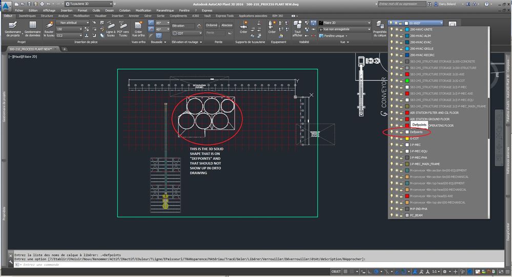

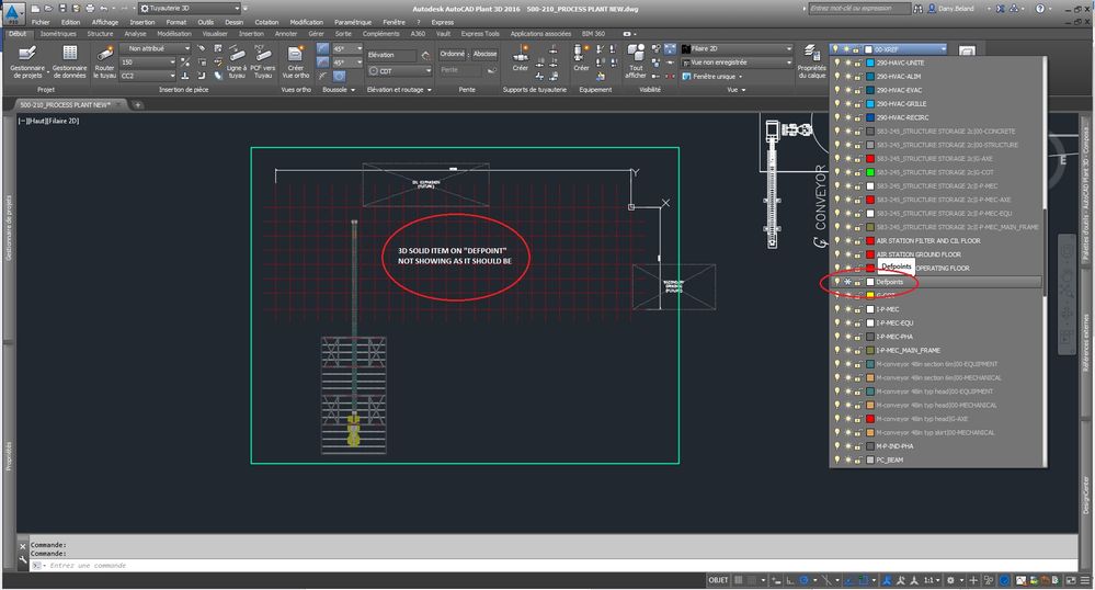

In AutoCAD Plant 3D 2016, I have a general arrangement with xrefs loaded in and a 3D solid shape on the "defpoints" layer that is frozen. When I produce an orthoview of the GA, the 3D solid object shows up. And if I turned off the layer in the viewport, the objects that were behind are still cut and gaps appears in my view.
Here's some screenshots

Hi Dany, I visited with this issue to our Plant 3D development team and they have recognized this is an issue. Currently they are investigating the issue and will be working to see how to address the ortho updating correctly with the frozen objects in a update or of future product release. I did find a workaround that you might want to try if you encounter this issue again. If you find the view will not get rid of the frozen lines by updating the view, try to edit view instead. I was able to just alter the size of the ortho cube slightly and this refreshed the view to remove the frozen lines. This should work for you too.

I discovered that all frozen layers disappear by editing the view "plantorthoedit" and then re-adjusting the view cube. When you select OK the ortho view updates and the view shifts slightly to your new viewcube size. Just move the view to your dimensions and annotation, but all the frozen layers should disappear.

For what it's worth I was having the same issue and found that it was due to having the model file open while accessing the ortho-view. The model had been saved with the layer frozen and that's how I wanted it in the orthographic, however it would regenerate the view with the layer showing no matter what I did. I then realised that I'd unfrozen it in the read-only, unsaved, open model file. After I shut the model file I had no more issues. It may because the native-state of the layering was confused? Not sure exactly how the ortho generator runs when "querying" drawings, but I'd guess based on this observation if they're open it looks at that instance, not the most recent saved state.
