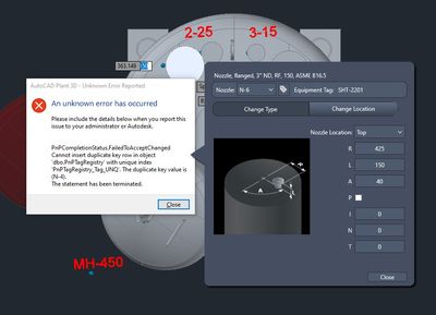

I'm having a problem with an error that "Failed to create 3d object data for one component, when i try to copy them.  They also not coped What causes this and how can I fix it
(only file in project is having this issue)
1) we can't delete nozzle
2) some nozzle tag text is missing & felid is there without text
3) equipment not copied even that same file also
some of nozzle tag text is missing and field is there on dropdown

MY PROJECT ON SERVER (SQL EXPRESS EDITION) ALL RAEDY INSTALLED AND ISSUE ONLY SOME OF FILES NOT PROJECT I WAS FACING MULTIPLE ISSUES PLEASE CHECK SNAPS
WHILE EQUIPMENT MODIFYING FACING THIS ERROR MOST OF THE EQUIPMENTS
ISSIUES IN EQUIPMENTS
EQUPEMET CREATED & AFTER SOME OF DAYS LOST NOZZLE TAG OR MISSING SHOWING BLANK ENTITIES IN POPUP.
IN SOME OF EQUIPMENTS EDIT PENCIL NOT WORKS
WHY EDIT PENCIL COLOR SHOWING DIFERENT SOMETIMES WHITE SOMETIMES PURPULE??
EDIT PENCIL COULER CHANGED AS PURPLE

On the first error, it's clear that you're trying to put a tag (N-4) that is already existing. It should be different.
If you haven't assign that tag, audit the drawing/project.

1) my project file we never open directly we are taken proper way from project path tray
2) as per your suggestion i wll audit my project daily basis before creating backup
3) about pencil purple color means i think its database error?
4) why equipment is not copy from same file & nozzle tag missing on going work
