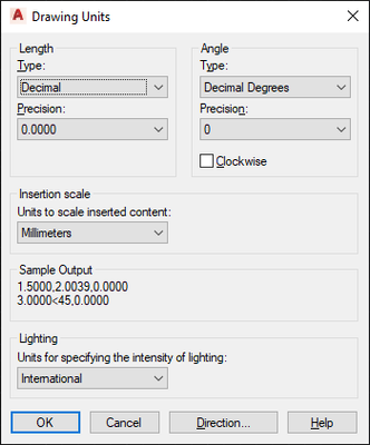

Hi All,
I've created a new a new valve for my libary, but when I insert it, it displays at the wrong scale although the port locations are correct.
In the image below you can see the large blue valve (selected), but the glyphs for connections and orientation are well inside that shape. Those glyphs are in the correct location, but the actual valve model is much much larger.
I've deleted, purged and re-created this model a few times, checking model, project and insert units are all correct, but it keeps doing the same thing.
For reference, I added the source block in directly (rather than converting it and inserting it) - You can see that model in the bottom of the image - at the correct scale.
Any suggestions????

Dear @gerrardhickson ,
please check the drawing units from your 3D files to your project settings - these must be identical. Imperial to Imperial, Metric to Metric.
this problem has been dealt with very often in the P3D forum. please use the search function in the forum.

Thanks for the reply. Rest assured I searched. Some posts indicate a similar problem, but the resolution hasn't worked. Appreciate your feedback.
Insunits in both (source and destination) is 4
Project units:
Source File units:
Have I missed something?
Note that in my case the glyphs for "continue piping run" etc are the correct scale - only the graphic for the valve is the wrong scale. Surely if it was a units problem they would be consistent?
the problem lies in the step file.
This comes from the imperial drawing units.
After the import explode the block.
change the drawing units to "mm" and scale the entire 3D model with Varia by 25.4.
Now you can create again with Block and continue working with PLANTPARTCONVERT to create a new valve.
That's how it worked for me.

gerrardhickson
Interesting find - Have a look at the DWG file I linked. The block units in that are millimeters... not inches. I had previously exploded the step file already.
Could you replicate the problem using the DWG file?

Fahad_YK
I have the same issue as You.
The easiest resolution for me is to make sure that the DWG file that contains the block has the same units as the Catalog (Imperial/Metric). As @h_eger said, the units must be consistent.
My Plant 3D Project is in Mixed Metric and I had to add imperial custom parts.
So I created the custom part in a separate dwg with an Inch/Imperial unit. Convert it to Block. Used PLANTPARTCONVERT and determine the ports' position.
Or if you have an existing parts model in whatever units it is, just create a new DWG with the same units as the catalog, then copy the content to your new DWG, explode, purge (if needed), scale as needed, convert to Block, and then followed up with PLANTPARTCONVERT.
