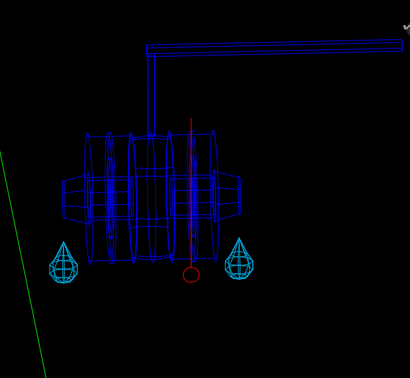

first problem:
If I have a valve DN40 PN40 in catalog I need to have one valve but this valve I need to use in pipe class with PN10/PN16 it means that I need to have 3 valve instead of one valve…
So its not a problem if I have 10 valve but if I have 50-100 valve you need maintenance 150-300 valve…
After 80 valve i didn't know what i was doing…

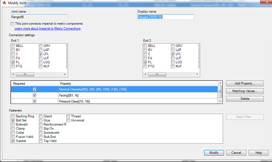

And i try to add for every diameter this allowances :
And its seems to work but only simple joint
Automatic flange ( compound joint) didn't work because we have also in this settings compare for pressure and faces but there is no additional option on which diameter and pressure rates..

Hi to all again,
I continued to work on this topic and here’s what I found. Its seams that I can simple joint connection simplify and instead to have 50 new connections we will have few new connections..
So everywhere I have flange connections I will keep original and add two new one
So I will first modify:
Flanged Joint:
(Facing B1/A)
And then I will add two more flange connection
Flanged Joint DN15-DN40
and set nominal diameter / facing and pressure rate
Flanged Joint DN50-DN150
And repeat this for LUG joint /Wafer Joint
And it seems to work for flanged joint but it’s stuck with wafer joint
