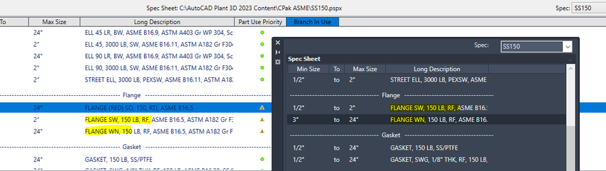

Hi Guys,
I have been trying to add a flange to the Spec SS150 (that come with the software), however it saved on the Spec Editor but not shown on the Spec Viewer.

Dear @zirudezirude ,
The flange you have added to your SS150 pipe class is in the content folder!
But you must adjust the pipe class aucs your project
or you can copy the modified pipe class files from the content folder into your spec sheets folder of your project.

zirudezirude
Thanks for the answer,
We usually group all client Specs in a separate folder (not within a specific project) so do we have to copy the defaults Specs in there?
I have already copy SS150 spec to the project, but did not work.
Also I did not get what you mean by "you must adjust the pipe class aucs your project"

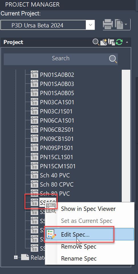

h_eger
edit a pipe class should be done from the project folder/Pipe Specs.
