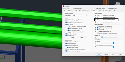

İyi günler autocad plant 3d programında çalışma yapıyorum fakat borular çokgen şeklinde köşeli oluyor bunun her hangi bir ayarı var mı ? şimdiden yardımlarınız için teşekkürler.

@sekarakaya ,
Yes, this is available if you change the shading mode from (fast) to realistic.

sekarakaya
@h_eger ,
This is not realistic what I am looking for and I have the same problem when I am in the shadow.I don't like the realistic look.

DVaquand
Hello @sekarakaya
Check the value of the system variable "FACETRES".

sekarakaya
 As shown in the picture, I set the facetres settings to ‘0.1’ and there was no change in the model

DVaquand
Hello @sekarakaya
If you disable hardware acceleration or vice versa does it change the 3D appearance of the piping?

h_eger
@sekarakaya ,
Can you tell us which graphics card you are using with Autodesk AutoCAD Plant 3D?

sekarakaya
CPU; İ9-13950HX
GPU: RTX 5000 ADA

h_eger
@sekarakaya ,
Can you please check whether your PC is also using your NVidia RTX 5000?
You can see this via NVidia Control Panel.
I also had to deactivate the internal graphics card in the BIOS because MS Windows likes to activate the internal graphics card to save power.
