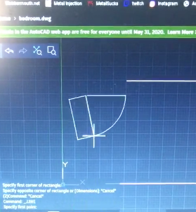

Hi All,
Looking for some help here. I have a student who doesn't have the Dynamic Input option when drawing lines or shapes. Did they accidentally change the setting? I can't seem to find anything on turning on and off the Dynamic Input on the web app, as the desktop commands don't work.

Hello Nicole @Anonymous
Welcome to the AutoCAD Web App forum.
Can you clarify which browser the student is using? Since I can not reproduce the issue on my side and it only happens for one student, the browser might be the issue. Furthermore the help does not mention something about disabling the dynamic input (See: Dynamic Input and Shortcut Menus)
Supported is actually: 64-bit Google Chrome, 64-bit Mozilla Firefox, and 64-bit new Microsoft Edge (Chromium based) on Windows or Mac (See: Supported Browsers and System Requirements)

Hi Thomas,
Thanks for the quick replay. The browser should be Google Chrome, as we are using Dell- Chromebooks, It's just one student, so I'm guessing you are right about the browser's support, as this student has an older Chromebook. I just wanted to make sure I wasn't missing anything.
Thanks for your help.
