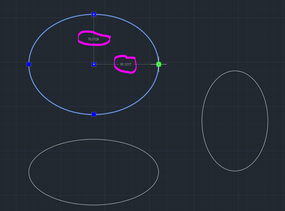

From the attached screenshots, you can see my modelspace. These shapes should fit comfortably filling out a page of a3 at 1:1.
2nd screenshot shows the layout, and the annotation scale set to 1:30. This is approximately how they should appear on the page when it's 1:1. I am aiming to print at 1:1, but the shapes are then tiny on the page: completely the wrong size. Screenshot 3 show the paper set to A3.... Am I doing something wrong or is this not working?  thanks 🙂
Forgive me, but how would I know that? I don't see any dimensions on those objects so I can draw them to follow along.
Annotative scale is about resizing text and dimensions inside a viewport. Your VIEWPORT scale is set to 1:30, and indication that your objects are too small to fill up an entire A3 sheet.
I'm going to guess there is an underlying problem you may not be aware of: what units of measurement do you think you are drawing in? Perhaps you want meters but are drawing in mm, or inches vs feet, or somethin completely different.
Either way, this all goes back to the question I had at the top of this reply: what sizes are those objects? That is where the fix needs to be.

I have put in some dimensions. I suspect you are probably right. I need to change the unit of measurement. I am trying to draw in millimeters. But there doesn't appear to be anywhere in the Web App to do this. I have changed to decimal in settings.... But the factor of 1:30 error might suggest that the error is mm vs feet autocad web model screenshot4.jpgautocad web model screenshot5.jpg

the drawing was originally created in Autocad (not the web app) and imported. This may be where the problem originated. I have just started from scratch, and I can now get the components the right size at 1:1 on A3 ...

Thanks for the DWG file: your dwgunits are set to inches, so this one oval for example is way bigger than an A3 sheet size could ever accommodate if printed at 1:1 scale.
That explains a lot.

There doesn't seem to be any way of checking the units in the Web App.
Especially as the dwgunits command is not supported.

@scottwoyka As far as I know your DWG file needs to be preset to what you need before using on WEB.
