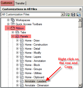

MultiLeader panel is not enabled in AutoCAD Mechanical out of the box.  However you may configure CUI to have this panel.  Please follow below steps:
1. Command CUI
2. Under "Customize" tab>>Ribbon>>Expand "Panels"
3. Under Panels>>Copy "Annotate - Leaders" row

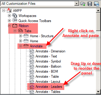

4. Under Ribbon>>Expand>>Tabs>>Annotate row>>Paste the copied row in step-3
5. Reorder the panel within Annotate tab if required by drag and drop
6. Click OK to finish the customization.
MultiLeader panel will be listed under Annotate Tab.
