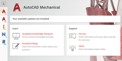

Like the title says, I get a 30-60 second freeze when trying to stretch a line or rotate an object in Autocad 2020.  I have already:
  • Attempted to update to AutoCAD Mechanical 2020.1.3.  The desktop app says I updated, but the About command shows conflicting information in the "Product Version" and "Built on" Lines
  • Tried turning 3dconfig on and off, no change.
  • Turned Linesmoothing and Linefading on and off.
  • Nvidia Quadro P1000 Drivers are up to date.
  • Windows 10 Drivers are controlled by IT department, but are updated regularly.
How can I stop the freezing with line stretching and object rotation?

Your about command screenshot shows you have the 2020.1.3 update already (last line).
Did this just start today?
Or is today the first install and use of MECH2020?
"up to date" is sometimes the wrong solution when it comes to video card drivers.
