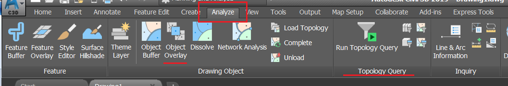

Maybe you know the capabilities of Analyse?

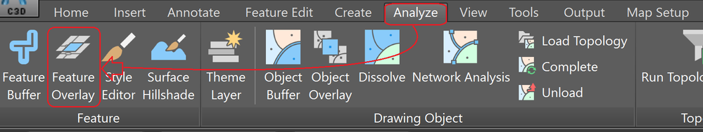

If you are starting with these:
  • Parcel POLYGONS in shapefile format
  • LINE shapefile representing your proposed optical network
...then you can accomplish this using MAPGISOVERLAY. For ribbon, go to Analyze Tab=>Feature Panel=>Feature Overlay Icon. Image-1.
1-Enter MAPGISOVERLAY on command line or use the ribbon.1-Enter MAPGISOVERLAY on command line or use the ribbon.
For your SOURCE, select your line shapefile from the first dropdown. For OVERLAY, select your parcel polygon shapefile from the second dropdown. For TYPE, select intersect. Click NEXT to continue. Image-2.
2-Select SOURCE, OVERLAY and TYPE.2-Select SOURCE, OVERLAY and TYPE.
